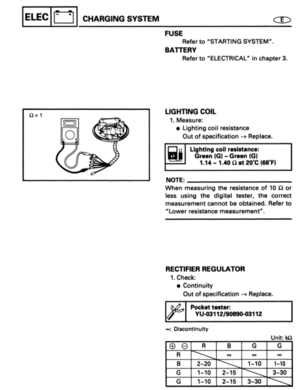

Then check battery resting voltage and then voltage while running at a minute or so of high idle and report back with the DC voltages.
After that, I would follow the service manual procedure for "Charging System" on page 7-11 and 7-12. Screenshot below so you can check your coil and reg/rectifier.
