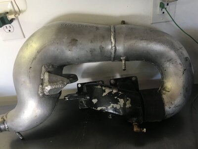

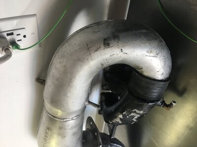

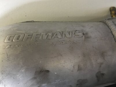

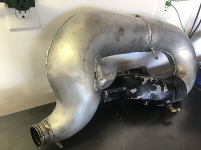

I can’t come up with much info on this Superjet pipe. Anyone got any info? I’m curious as to how I should route water as there is lots of fittings all over chamber... hmm sounds like a long day of tuning for me!

that aint no litening dry pipe. that's a very old style of a stamped rocket pipe. I've had a couple thru here but they are problems as you can see by all the repair welds to that bracket. everybody has such a problem figuring out water routing and I don't know why. its as simple as water in, water out. blow into the fittings and see where the air comes out. it either pisses into the chamber to cool the pipe or it cools the water jacket and comes out the opposite end of where it comes in. cant remember if the first section of that pipe is a double jacket semi dry or not and the tail section is wet. very easy to figure out but it aint in front of me.

Excellent! Thank you for your insight. It came with a brand new R&D water control module as well. Billet purple unit that should be a nice addition to this 760 Superjet I’m currently building. Trying to get high rpms out of this setup so I’m going to run this pipe dryyyyy we shall see how fast I melt couplers haha.
