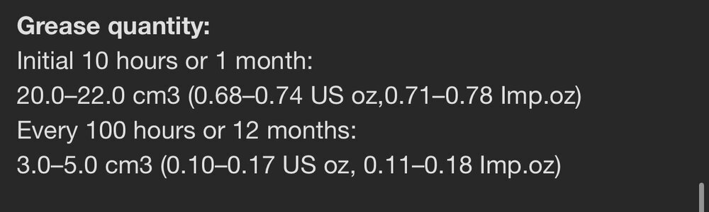

Alright, buying a mint 2019 superjet with low hours. Guy never greased mid bearing. Thinking of pumping in .68 oz of grease. That’s what the manual says to do after the first initial 10 hours. What do you think? Then every 1 year it said to pump .10 oz in.

If the pump has been out make sure to pull the mid shaft and clean/grease the splines inside and out. Most owners are to lazy to do this and end up getting sand in their splines when they reinstall the pump. Thats the real reason there are so many stripped mid shafts out there.
