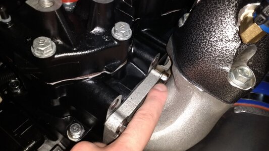

so what did you do there, grind it down looks like? and those are the bolts you had to cut down a bit?
Yeah I grind the outside of the wrench down (dont go too far otherwise the wrench will not grab the bolt anymore) then it fits onto the bolt and you can turn the bolt in step by step. The bolt looks a little messed up because I did not shorten them and just brute force them in since those two critical bolts where the last once. I did not feel like undoing everything again. DON'T DO IT THIS WAY I had my fun once I had to remove the pipe again.....You will save your self time and a headache if you just cut them down a bit. Also for tuning the pipe I found it very difficult to reach the bottom screw(on the headpipe) you can get some adjustable T screws for it from Jetmaniac that makes tuning the pipe super easy and they are best installed when the pipe is not in the ski.
