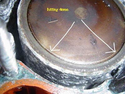

now the pics, I pulled off the head and found these marks on the pistons, looks and is the pistons hitting the head, not hard but it is hitting, the head is an o-ring style but I know a gasket would raise it enough to clear

You need to check the squish relief and make sure it is not way too small. What cranking compression are you running? Are you running a standard base gasket? Looks like you have some major clearance issues going on there.
