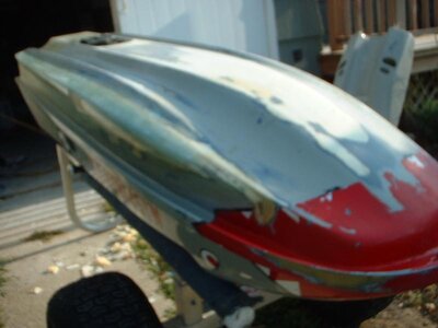

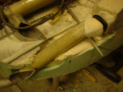

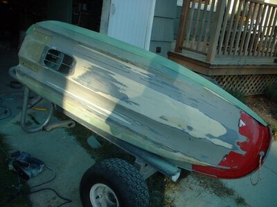

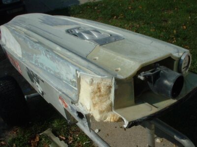

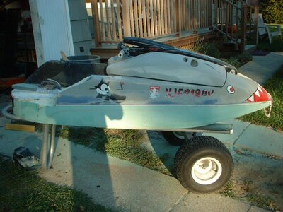

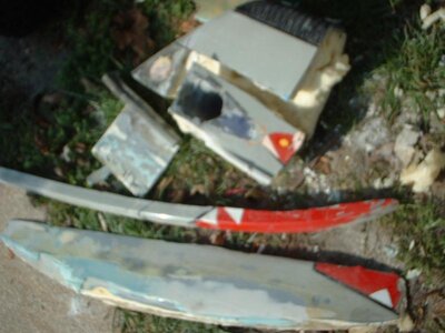

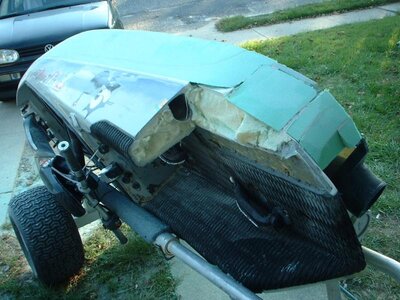

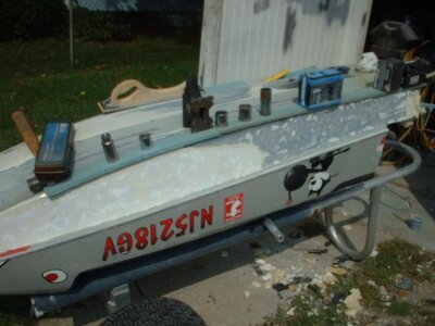

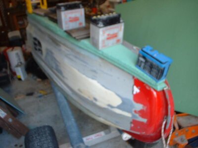

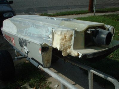

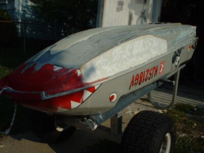

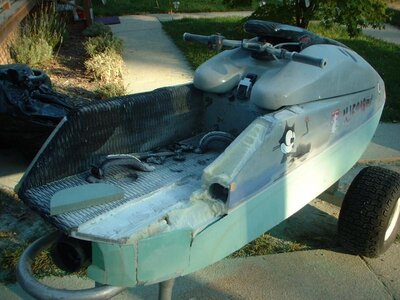

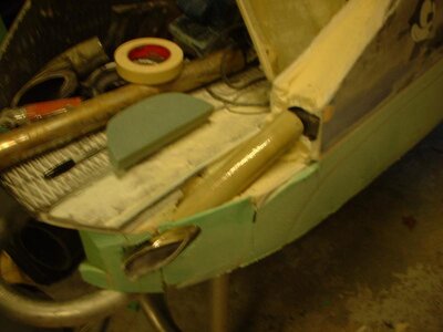

Here I go again.... The rails I added at the begining of last season finally let go. They were made from surfboard foam with 2 layers of 6oz. cloth so I'm suprized they lasted as long as they did.I did like what they did for the handling but it was'nt perfect.
This time I'm making the tail narrower & rounder including the top. I also filled the area from the chine to the outside rail droping the edge of the rail @ 1/2in. Saw no need for the bond line rail so they got chopped. The shape of the ski should end up pretty smooth from top to bottom with the wider rails. Lots of shaping to do, the front of my garage looks like it snowed.
