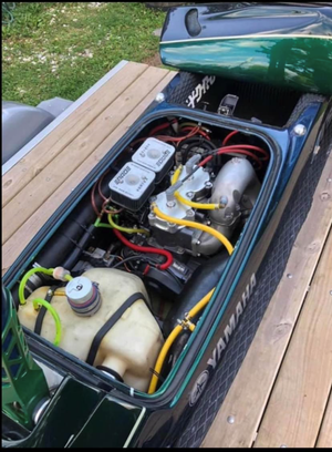

I am hoping for some insight on why I am running out of top end. Not sure if this is normal with superjets or not. After about 5/8 throttle the rpm rises but there is no change in speed. Seems like the entire span of the power band should work. Guessing maybe the impeller is the problem but I am not sure.
2012 Superjet
Specs:
mild built 760 ported and polished
dual 44 mikunis
factory b pipe
msd enhancer
Jet maniac water box
tbm lightened flywheel
rrp trim
I also know it has aftermarket ride plate and intake grate. Not sure what the impeller is is though.

A pair of 44s will make very close to full rpm at 5/8 open throttle. A pair of 38 need to be open a little more but will do mostly the same thing. Large carbs will make the pipe hit harder at low speeds but thats about all.
bored&stroked
Urban redneck
AZ
Do you have a tach to confirm the rise in rpm's?
My first guess is its blowing the impellor away, maybe from damage, maybe from power, but I'd look there first.
WFO Speedracer
Alabama
You would have to remove the pump housing and get the numbers off the impeller, if it's a stock impeller there may no be any numbers on it
