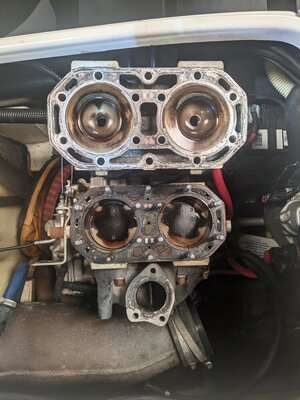

First, thank you Storbeck, Bill and Bird! I have some results, went to the lake for a day trip. A lot of driving, but good to be riding.
I put the carbs to the FP specs (152.5, 80, 1.5/80g) as a starting point. HS needle was 1/2 turn, LS I started with 3/4 turn out. The other changes from last month was the new reeds, the top water screw set to 1/4 turn and the bottom set to 3/4 (mid closed). Pop-offs measured 29psi with cover off and on and the lever was adjusted to be level with the carb body. This ran pretty well, although no where near the hit of the SJ down low. It started instantly and transitioned smoothly from idle to WOT. WOT felt good, as it always had. I did adjust the bottom water screw in 1/8 turn, which didn't seem to make any difference.
Then I saw Bird's post and decided to change my pilot to the 72.5 (stockers) that I had on me. This was easier than expected on the beach as I went prepared with tools. I only changed the pilots, no other changes to needles/other components. This definitely ran better. Starting was instant, it idled well, and the low end hit was getting better. Rode it like this trying to test if it was loading up, hesitating, etc and it just ran the best it has since I've owned it (since '09). After riding a good bit, it did some funny stuff here and there...inconsistent behavior. Hmmm. Considering Bird's input on the main jet, and knowing this jet works in parallel with the needle, I figured I'd try tuning the HS needle. I put the ski on the trailer (in the water), and started doing plug chops. Houston, we have a problem. Ends up the gasket between the manifold and head pipe was blowing water into the hull when revved. It also wasn't cleanly revving from idle to WOT on the trailer. Hmmm. After some thought, decided to leave it alone until I got home, was worried about a bed head gasket or manifold gaskets.
Trying to figure out how water was coming out of that joint, I started tearing into it this evening. The three bolts were snug, but not super tight, and the gasket was absolutely disintegrated (see pic below). I hadn't realized that the Kawi FP manifold has coolant passages at that joint (none in the head pipe though). Why? The SJ is a big solid face to seal to, but not the Kawi! I pulled the manifold and the two gaskets to the cylinder were damaged, the water pressure obviously pushed the metal into the cylinder coolant passage at the bottom. They looked to sealing ok in spite of this. So, this may be why I started getting funny behavior...uncontrolled water leaking into the exhaust and exhaust gases possibly coming into the hull (likely not a significant amount, but who knows). Maybe this is why the water screws haven't seemed to make much difference. I'm tempted to weld up the manifold at that interface and machine the face flat to provide a solid sealing surface. Anyone done this? Anyone know if the exhaust manifold is easily weldable with a TIG and aluminum rod? I've welded on FP chambers before, and on my SeaDoo cast exhaust manifold and they welded fine and the repairs have held for many years.
Compression...I'm a bit of an idiot. I pulled the head tonight since the plug chops didn't go well to check for 1) blown head gasket and 2) piston wash. Thoughts on the piston wash in the pic? I'm thinking they look good. Remember, this is with a decked stock head (minimally decked, squish bands NOT machined), 152.5 mains and 1/2 open HS needle at 4200 ft elevation (oh, and 100+ deg outside). I burned over 5 gallons of fuel today for reference. The plugs are a medium to darker tan.
Back to compression, I tested it again. Both plugs out, strong battery, throttle full open and got 140 psi in each cylinder. Hmmm, why is this lower than a week ago. Well, I realized that the hose on my tester is BEFORE the check valve, so it contributes to the head volume. Just how much does it contribute? I couldn't find a syringe to measure it, so I measured the two end fittings (hose likely a bigger diameter) at ~.2" diameter. The hose is 18" long! Oh, and the o-rings on the end to seal to the head suck. If I did the math right, that's an extra 9.26 CC's of volume just in the hose/adapter! Wow! That probably explains a lot of the "low compression". I did look at the cylinders and piston skirts thru the exhaust ports...pistons look like new, zero scuffing and the cylinder walls look excellent, no scratches can be felt with a nail. Maybe it could use rings, not sure, but don't want to get into doing the top end right now. If I went that far, I'd have the cylinders ported too, a project for another time.
So, will need some gaskets. Question is, aftermarket head, reuse this one as-is, or have this one machined? Ends up my lathe can't quite swing the head over the ways, and isn't a gapbed. Bummer! So, it'd need to be sent out if machined. Recommendations on which direction to go? Want it pump gas safe (91 octane here), and not really interested in going with girdles at this time, unless absolutely necessary. I had an ADA on the SNSJ, and have an old Blowsion on the RNSJ. My SD XP stock head was machined by Rossier. All have worked fine. Also, recommendations on a good compression tester!?!
Again, thanks for any/all feedback and advice! One last thought...I'm considering changing the main jet to something a little smaller and opening the HS screw to compensate. This would give me more ability to lean it out, if needed. Not sure it needs it though given the piston wash. Feedback is MUCH appreciated.
