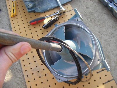

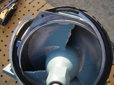

think i found why the square was cavitating. you tell me
Dubs chops
livintit dot com
okay i took off the pump and the seal between the pump and the hull was chewed up. where can i get another one? anyone have a clue? also the prop looks like it has had acid poured on it, it looks as if it has eroded and ate a rock or two.

Just about any place can get the seal so chose who you like to deal with.
Doesn't cost much at all.
The prop, or what you describe as acid burn is cavitation.
That stocker is toast and should never go back into any ski.
Mouthfulloflake
ISJWTA member #2
NW Arkansas
that impeller would make a $30K ski run like crap.
throw the impeller away, buy the new packing ring, inspect the pump closely for wear on the veins behind the impeller ( easier after you remove the impeller), sometimes they start to erode from the cavitation also.
