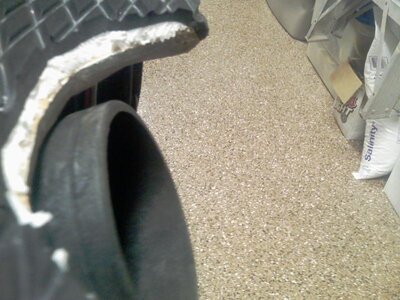

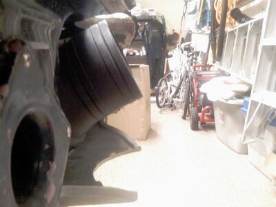

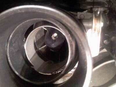

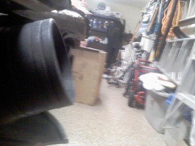

so i figure i have about 34 deg of trim and i have it on a pulley system which makes it great. i used the stock sxr reduction nozzel with a x2 trim ring ans steering nozzel. i custom made a plate out of billet and put the 1.5 inch pulley on the trim ring then i feed the cable housing through the top of the plate and locked it in place. then the cable comes out and around the pully and back to the plate. i used the terry cable with a barrel end on the leaver side. i used a bmx brake leaver the v-brake kind provides more pull due to the piviot points, and that is how you do a c.a.t.s. let me know what you guys think :bump::icon16:

oh ya smooth as butter i still cant open full brap but half or so i can open just make sure you make keepers for the pulley so when you land it does not pop off a spring is not enough
the pulley makes it easier. i've been researching doing a different set up but so far all i can find its yami threads. but from what ive seen you want a a harder pull. so i used a primo j-lever from a local bike shop its a 1 finger lever and it was 15 bucks. i had a pulley on mine it was too easy threw me off once or twice. so i scrapped it and threw the 1 lever on and love it.
st.pete
the pulley is on the pump the lever is up to you but yhe v-brake lever gives the most pull what do you want pics of sxr i can go to the garage and take some
