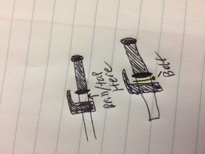

Drill and tap a bolt threw the handlebars only allowing the throttle to open desired range? Then you can screw or unscrew the bolt for more or less throttle?
