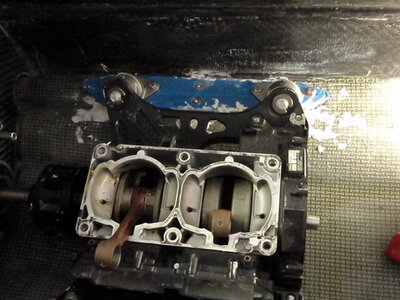

pump shoe installed now time to align the engie mounts for the rrp adjustable system .

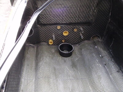

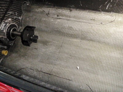

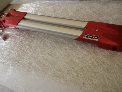

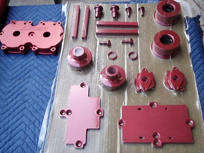

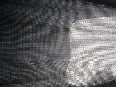

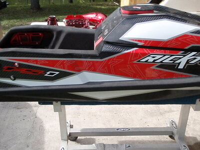

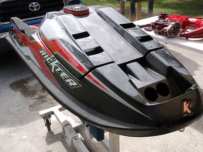

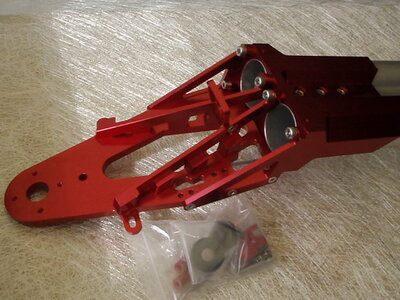

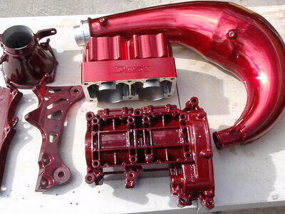

pics of the hull as i received it . some pics of alinging the adjustable mount plates . some the red powdercoated parts and some of the reanodized red parts to make this ski shine

nice. Your powdercoating quality looks real nice. Question: would powdercoating the pipe would prevent chamber cooling?? I have a b pipe and thinking about powdercoating it...
THRUST
ThrustInnovations.com
no this is a dry pipe so the actual coated chamber is all watercooled to cool the interior . you cannot anodize the chamber because there is no way to clear all the acid out so i powdercoated it and it turned out even better than i imagined i think this will really complete the ski for the extra bucks put towards these little details .
Bringing custom back into custom skis
THRUST
the problemn with the b pipe is the top powedercoated already i have done them in the past but the chamber is cermaic coated and a bit harder to remove then paint or powdercoat but can be done
