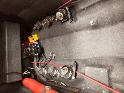

JM, I just built a SV Pro and Tony told me to use the stock superjet mounts. I installed six of themmounts.jpg
