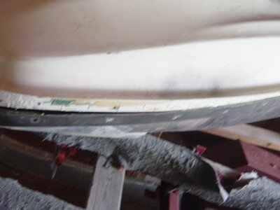

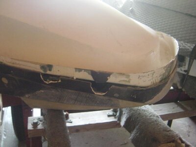

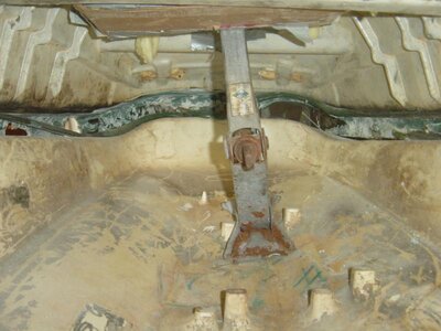

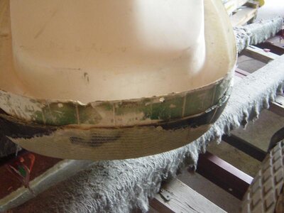

yahoo!!!!! got the front part totally separated!!!! now the back my the firewall will be a bitch....
i used a chizzle around the outside of the boldline to separatet them....
and my tool of choice is a CAR JACK!!!!!! i just cranked it up a little and then chizzled from the inside.
i got the front half separated in about an hour!!!!
not the back may be a little more tricky!
hopefully i can get the firewall out, then put the jack in and do the same thing.
little pieces chipped off, but it was my fault from that!

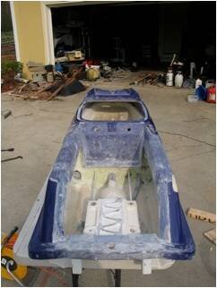

Hmm, well: if you have the time I guess. But you can do anything you need to in the tray area by hacking the tray out. Here's mine:

Last time I cut out the tray it was a biatch to get back in!!! Plus I'm redoing my bracket area and reinforinng the $hit outta it so that sould make it easier. I'm already half way there no turning back!!!!
