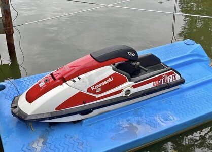

I purchased a 1987 Kawasaki 650 SX from the original owner.. can't make this stuff up --- He's 84, and I watched him ride it. I hope this experience was the universe allowing me a glimpse of my future.
In any event, this is the Jet Ski I could not afford in 1987. It's basically original except for the carburetor. The ski actually runs, and it's rideable, albeit slow. I literally took possession of this old girl on the owner's dock -- the first time in my life I've ever purchased and kicked a ski off the dock and ridden it home. This guy told me he's never touched the engine ... Compression 90/90
Would you - drum role - A. hone and slap -- B. Hone and replace piston and rings -- C. Perform a complete rebuild
I'm thinking based on a compression of 90/90 and the fact this thing still runs and throws a jet that this engine has worn evenly. I am in Georgia and can ride through October/November. I'd like to get some tray time before committing to a full rebuild. At this stage of life - 37 years of use - am I risking grenading this thing with a new top end? Does anyone have an experience to share?

Just saw the pic - that is a stock headpipe with maybe an upgraded tailcone. You should do the dry-pipe mod for sure. It's virtually free outside of time and yields a nice improvement. FWIW I didn't even add a nipple on my tailcone and just routed all water overboard.
When you mod the exhaust make sure to check for a diverted ex manifold and upgrade if you don't have one. They didn't come on 87s and are a key piece to the overall system.
Lastly - you'll want to replace that red head as they have been known to warp.

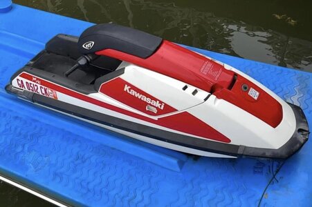

I really believe this ski is untouched ...

Hull looks mostly original outside of the nicely updated chinpad.

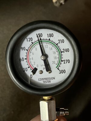

I'd bet your compression gauge is wrong. A 650sx hitting the mid 30s is about as fast as they go stock. Check those readings with another gauge. 90 psi would barely run and definitely wouldn't hit 30s. If it pops your finger off the spark plug hole. It's not 90.
Throttle wide open. Known good well charged battery.

Thanks for replying ... I was thinking the same with respect to the gauge. I checked again last night ... cold engine, carb removed - open intake - and I used the screw-in adapter. Essentially the same result. The battery is new although I did not actually check the charge. The engine seemed to turn over quickly and I cranked to the count of 5/1000

A top end that wore from 145 psi to 90 psi. Evenly. Is very unlikely. I've never seen a 650sx with les than 120 psi. Is it possible. Sure. It's much more possible your gauge is wrong. That's why mentioned using a different gauge. It should spin over fast. It's a tiny little engine. You can also very clearly hear a low compression engine with a little experience.
Does it pop your finger off the plug hole when you try and hold your finger on the hole. And when it does. Can you feel the air rushing last your finger, get very hot.
A ski that had 90 psi would be incredibly hard to start. As not just because someone slapped the 44 on it like every joe blow did. Totally possible it is worn to that point. Unlikely tho

Yes, the compression absolutely blew my finger off. I checked again with the same gauge and this time used the rubber-tipped fitting instead of the hose and screw-in adapter. I checked 3 times and achieved 145-150. Thank you!
