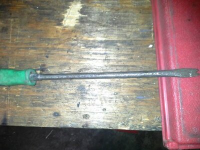

One of my ideas that I can think of is a tool to aid in installing fuel tank, battery and waterbox straps. I took a long flat head screwdriver and cut a grove in the flat end. This way you can put the loop of the strap in it and use this to push out into its clip or bracket.
I hope i'm not the last guy with this idea for a tool. What other ideas does everyone have.

Here is the screw driver I was talking about. It took me 5 years to think of this.
The bungee cord is a great idea. Never thought of that. I always try to wedge them between the handle pole and bracket.

Watcon Sells a tool exactly for that.
