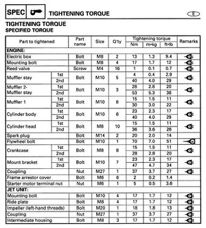

Mike W Infidel Location North Florida May 10, 2008 #2 Found this with a quick search. Attachments TorqueSpecs.jpg 137 KB · Views: 58

K Kennay Squarenose for the _____ Location Myrtle Beach, SC May 10, 2008 #6 I think it is telling you which loctite to use

stanton High on jetskis. Location atascadero,ca May 10, 2008 #8 Kennay said: I think it is telling you which loctite to use Click to expand... ..and what loctite is that?

K Kennay Squarenose for the _____ Location Myrtle Beach, SC May 10, 2008 #9 five0addict said: ..and what loctite is that? Click to expand... I think you may need to zoom in to see the numbers better I can only make out a couple of them myself... My monitor is at 1280x1024
