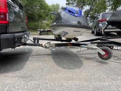

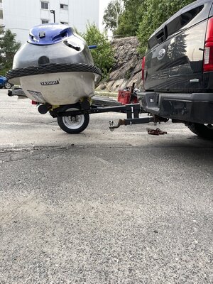

Going to a friends cottage for the long weekend and I want to take my superjet, and 2 sitdowns (Seadoo 130 GTIs). I have the sitdowns on a dual trailer, and I either take the superjet on my hitch hauler or its own small trailer. Now, what I plan on doing is using one of these and hooking up the seadoo trailer to the lower part and my hitch hauler with ski to the higher part. Just wondering if anyone has done this before. My only real concern is the front end getting a little "floaty" from the tongue weight. I have a 2018 f150. My other thought is to put the ski in the bed, but with only a 5.5' box it would be hanging out quite a bit.

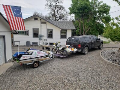

I tow my couches behind the ez-ski hauler. But this dual hitch thing looks pretty cool. If you end up using it post some pics.

Dudes buddy has like 5 skis and dirtbikes. But 50 dollars in trailer setup to get them somewhere safely. Jet ski ski guys I swear
Yeah that doesn't look safe. A couple things that stand out to me:
1.) If you take a tight turn it looks like the winch on the couch trailer would hit your ski on the hitch mount.
2.) Keep in mind that using an extension on your hitch mount means that you have to multiply the weight by the length of the extension. The connection point with your truck's hitch is essentially the fulcrum and you have to take in to account the distance to the load.
3.) Earlier in this thread someone mentioned that insurance companies often don't cover towing with an extension or a hitch mount...this is true to my knowledge. Def. check your liability coverage before you do this.
Props for ingenuity - this is great in theory.

Ya I ended up throwing it in the bed. My original reluctance was the pain of loading/unloading it from the bed.
I did however use that hitch hauler + trailer setup on my way to and from the local launch, which was maybe a 2-3min drive.
In the future, I think I am going to build some bunks on the front of the couch trailer and sit the superjet on the front of the trailer. Just need to figure out if it will be too much tongue weight or not.
