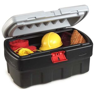

I got some locking 55 gallon size construction storage boxes from home depot for 50$ they are bigger that all the others i have seen pictures of on here and they have a handle and wheels so if you use a pin system to mount you can take them off and roll them where ever. it has a tool tray on one side i keep all kins of stuff in it gas cans, goggles, boyes, spark plugs and other parts and you dont have to worry about your stuff because it has dual locks and you can add pad locks to the latches as well.i seen they are 68$ now .
