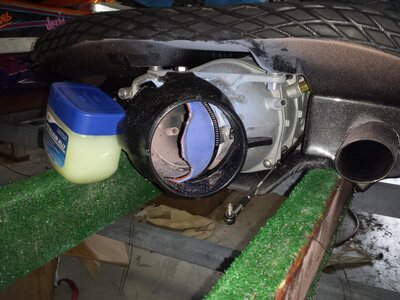

I had to file my nozzle a little on the bottom edge, but nothing extreme. You do need a trim nozzle, most commonly a 62T from a raider. Should be the same as the late model super jets...
Ok, so in order to make this trim system work, I need a 62T reduction nozzle, is that correct? Do I need a different turn nozzle than what is on my current pump. The pump/reduction/steering nozzle I am using came from a 94 SN?
