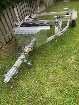

Triton Lite capacity?

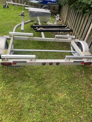

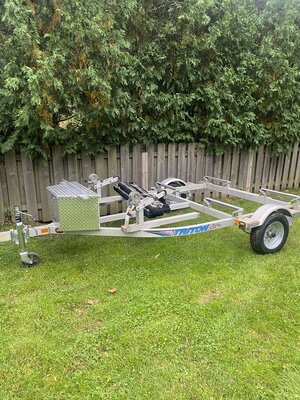

Does anyone know the official capacity of this Triton Lite trailer? There is no sticker showing the GVW either only the safety sticker.

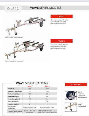

I saw that online for the newer ones. I don’t think that is my model (?) My width is only appx 92”. Maybe it’s same? I don’t know and Triton wasn’t much help since my trailer doesn’t have the sticker

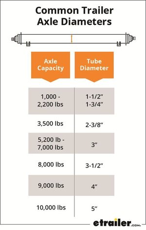

I am also in process of this on my triton lite. The axle is rated approx 1500lbs.
As far as info. Their latest line of triton wave trailers is the closest resemblance to the previous lite or WCII setup. Same overall length and width and weight. I found an online brochure the other day and compared it to my triton lite.

I’m toying with the idea of putting my 22’ in the center and 93’ and 14’ on each side. That’s about 1500 fully loaded with extra gas tanks

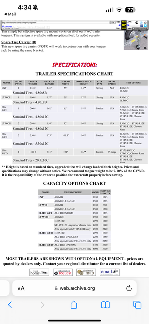

Yeah im trying to figure out if I can mount 2 blasters and a 99 GP800 on my Triton with the torsion axle. 1 blaster may fit on the front if I can figure out how to mount bunks.

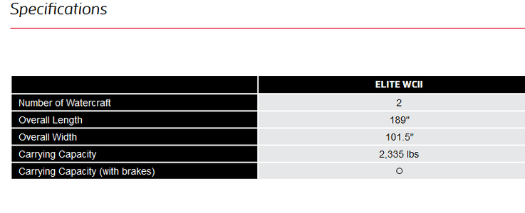

yeah looks like about 2300 pounds. Even when adding fuel I should be well under that.
320 blaster 1 + 320 blaster 2 + 500 GP800 = 1,140 pounds
