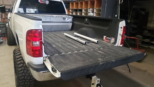

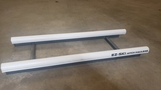

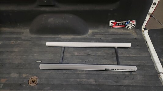

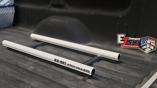

I was thrown off by the word 'Tub" im assuming you are calling the truck "bed" the "tub" . Anyways Polish_20200420_085731947.jpg20200410_140631 (1).jpg20200410_140657 (1).jpg20200410_141056 (1).jpg
