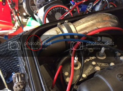

I found this pic of a ProTec pipe in a freak, not sure what model but this area will give you trouble just getting the chamber in. The dry pipe chamber is bigger all around so say goodbye to your hoodseal.
I'm kind of amazed that somebody put an old school pro tec pipe in one.
Where did you find that pic? I thought I had dug through every superfreak thread in existence.
Found it....and he went to a B-pipe becuase the pro-tec wouldn't fit, or at least he didn't like how it fit. So yeah that doesn't bode well.
The one in the pic from this thread is in some kind of pretty small looking hull though, I can't tell what it is but probably a Rickter of some sort.
The Type 4 looks like it might swoop forward a little more than the pro tec (?) maybe. I would be looking for a rough one to modify so I'm not above a few love taps, but at this point the lack of confidence put this into the "maybe someday" list for me.
