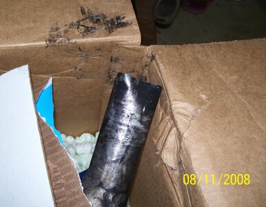

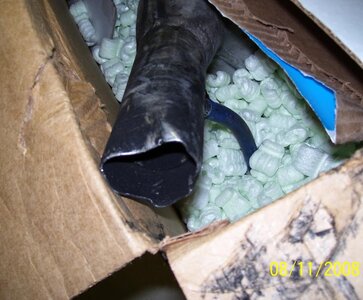

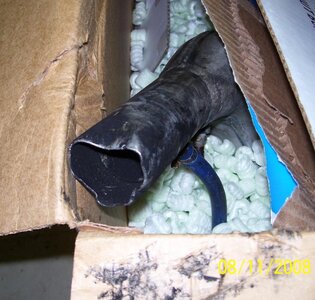

so I got this pipe, and Kennay said something about shortening the stinger to make it easier to install.
thats GOOD, since the stinger got deformed in shipping.
will it hurt or change the performance of the pipe if I trim 3/4" off of the stinger tube? ( its like 5 inches long...)

ok cool, I didnt want to try and straighten it, and it looks to be a Beeyotch to try and collect damages from DHL...
Ill just shorten it.

I would take a socket or something the same size and open it back up and peen until its back in shape.

How would you think it would change the performance? Cut it back to almost flush with the jacketed area and run the sum bitch.

I'd trim it to the jacketed area, you will see why when you install it. Had it been any steeper of an angle with my rn waterbox, I would have cut it some more. Crammit actually did the cutting if it makes you feel any better.

I can cut past the deformed part, and have plenty left to connect to.

I'd cut that stinger down for sure, you'l still get the restrictive/resonance effect from the smallest part on the stinger end, and cutting it shorter won't change the diameter, unless you're cutting it back up to where the chamber is!
Worst case scenario, you bust out the tig and weld a bit of tube back on.
