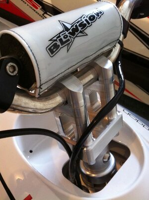

I spent some time looking for a riser that will work with my UMI steering system and I didn't have any success so, I decided to make my own. These pictures are when I was checking how it fit up before sending it to anodizing. It sits over top of the UMI so no modification were needed. The riser raises the bars 2.5"ImageUploadedByTapatalk1365004776.673553.jpgImageUploadedByTapatalk1365004830.810413.jpg
