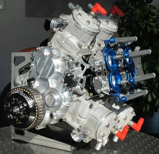

When is Dasa or PHP coming out with a v-4? :D
800cc 215hp
1025cc 275hp
http://www.aaenperformance.com/v4_racing_engine.asp
95lbs 18W 16L 14H
If someone had the capability to properly develop that into a race ski of some sort I bet it could be sorted out with a money is no object budget. The 200hp version would be the only one worth messing with imo. I'd expect about 10 hours of life out at best until major r&d time was completed. With a jet ski the cooling system is going to be capable of running very cool compared to any other application. Carb tuning would be extremely crucial when you're looking at 10k rpm. Too hot or too cold in those cyl would be trouble. Not to mention the exhaust would be major fab work... The potential to have a reasonable service life is there just a lot of r&d time to get there. Problem is you're looking at a lot de tuning to accomplish that. Just my 2ct I'm not an engine builder

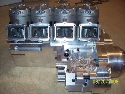

The trick would be to use a 90 degree v-twin as a v-4 would probably have less tq than a similar displacement twin. Big Pistons take big gulps and slap a big ass more than little pistons. Easier to fab. Lighter shorter crank.
Carbs would be in the center of the twin. Maybe even just start with a single 50mm carb. Pipes would be smaller than a b-pipe but then there'd be two of them. X cross through a single waterbox and I'm thinking dual exhaust out the back or even out the sides for r&d.
Hmmm. The gp800r/1200r cylinders are individual.... just need a custom crank and crank case.... maybe start with a Suzuki tl1000 or similar Ducati crankshaft
