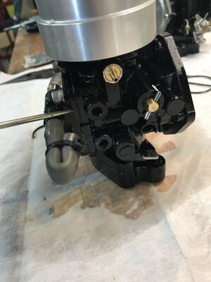

Attached are some pictures of my carb and stator. Is the timing right? Looks like it's stock timing and isn't advanced or retarded any.
Reeds are in good shape. One was starting to curl a bit so i removed it and flipped it to make it "seal" again.
I did another leak down test with flywheel off and you can see the small leak on the front crank seal. Will that SMALL of a leak cause this issue. Funny that the mag side piston did score a bit before rebuild. But having a very hard time thinking that is my issue now.

Pressure test your carbs. Make sure your needle and seats are sealing well. I chased my tail a long time just to find out my slave carb had a bad leak. (See picture) You just need to rule out the carbs before you can go forward.
