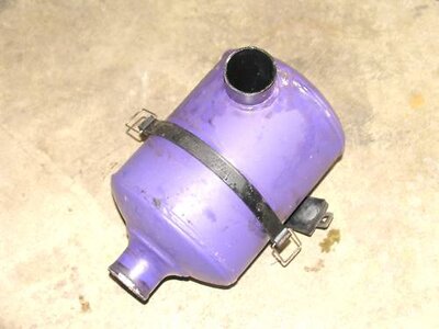

I'm borrowing a buddies metal SJ waterbox but need to give it back.
I've been on eBay looking at different ones and it looks like I might be able to use one its off a Seadoo 650.
I've sent a e-mail asking for diminsions etc, but wanted to ask ya'll what you thought.

Ok, heres another one I was looking at, this is the first guy to respond with dims,
Inlet and outlet are 3", its 16" long and 10" around (circumfrence). The inlet size sucks, but the size and shape might be ok.
