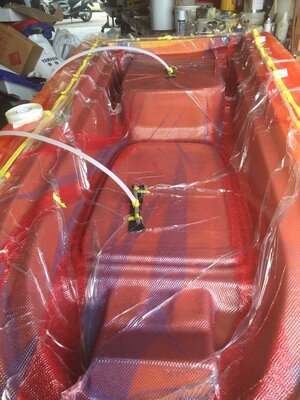

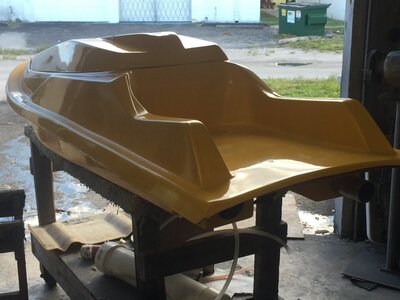

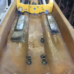

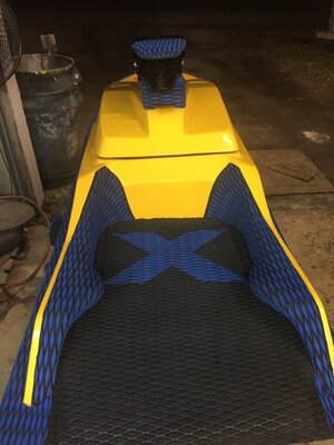

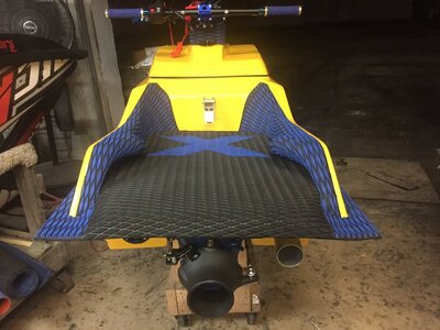

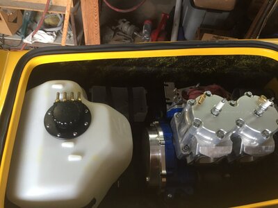

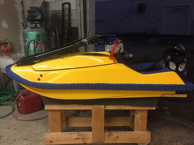

ok, here's the latest build of our new vision X . This is A fully resin infused glass hull weighing in at around 77 lbs. here's a list of the set up
- aura handlepole set up
- 144 Solas mag with 11/17
- dasa stock stroke 7 port billet cylinder (785cc)
- b-pipe+ RRP water box
- stock electronics +msd enhanser
- thrust steering +scupper
