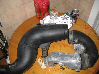

so i have a line coming in from the pump and and line to a pisser need help routing this set up on a 701 61 x tried to label it so hopefully someone can brake it down for me

I have no idea if this is right but, seems like the routing would be the same as a b-pipe.
Line from pump to #5
Line connecting #2 to #4
Line connecting #3 to #6 (tee'd to bypass (pisser))
Line #1 (to bypass (pisser)) or Plugged
Use a 4mm restrictor inline on #1 outlet to a bypass.

im confused what do you mean ....bypass?
You do only have 1 line coming in from the pump right?
To help keep the pressure up for the pipe feed you should put a 4mm restrictor in the #1 out from head going out to a pisser (bypass), if you run a 2nd pisser (bypass).
Block it off if you run only 1 pisser (bypass) that is 'T' ed into the #3 to #6 line.
