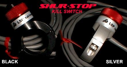

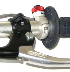

Has anyone tried using these shur-stop kill switches in the saltwater?
It looks like it would work perfect for doing away with that bulky black plastic switch assembly.
They have a waterproof o-ring design, silver plated contacts, anodized aluminum construction and a U.V. resistant cable; so I'm thinking that it might work great for jet-ski use.

I was thinking about using a switch on ether side of the handlebars for run and kill. This would allow me more room for mounting a larger 10-1/2" crossbar pad for protection.
A lot of people make billet lanyards but I'm not sure who makes the best one for saltwater use. I'm going to mount an aftermarket lanyard on the pole or on the dash somewhere with bypass connectors mounted under the hood so I don't have to run it in the surf.

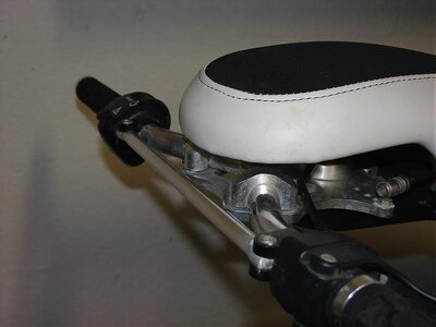

There's nothing wrong with my bulky three in one switch housing, I just don't have room for it. I'm going to be mounting a trim lever on my ski real soon and I'm just looking for ways to make more space for my large crossbar pad. I'll have to use an aftermarket lever on each side with a switch on each side so the spacing will be even.

where did you get that longer pad bar?
I assume the clamps are the regular UMI ones?
cool setup.
cool setup.
It's something that I made from 1/2" aluminum rod purchased at Home Depot.
I put both ends of the bar in a press to make the rod flatter to fit inside the standard UMI clamps.
Thanx, it's worked out very well and I would never go back to the smaller bar pad.

I'm just thinking out loud here, but wouldnt you be better off using an xmetal turn plate with straight bars and use the chinpad for protection?
It seems that by adding the protection of the bigger crossbar, you are just introducing somthing to crack your skull on!
The only reason I say that is because I don't think I've once hit the crossbar. The chinpad, yes, but never the crossbar.

I was thinking about going with a shorter xmetal type turn plate with 0 degree bars mounted straight through so I could use make the handlebars a custom length.
I'm also using a big pad with that crossbar but it not shown in the picture because it came lose in the surf. When I had my shorter crossbar pad on I was constantly hitting my knees on the clamps.
I'm all for heavy padding in the surf and don't see how some of you guys are running no crossbars pads with carbon fiber turfed chinpads without taking a chance of getting seriously injured.

Maybe I'll give one a try as a blige switch. Do they have a "toggle" type or are the all momentary?
This is just a momentary switch that can be used as a start, stop, or maybe for CO2 trim system activation.
