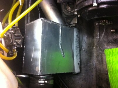

the pf water box shouldnt choke the motor.i ran one on my carbon chamber as well
When I cut my pfp waterbox open to reduce its size (fit in my q8).
There are 2 one inch pipes vertical one of which is covered 90% by the inlet pipe. Not very good for flow. Lets have everything run thru just one 1" pipe and out 2.5"
