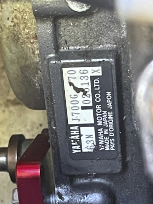

62T cases w/ 62T 701 cylinder, with dual 38's. WaveVenture 701 and the XL700(WaveVenture bottom/top hull with new design steering pod - starting 2006)have them.
If memory serves correct, the only difference is that the 63N is missing the second fuel pump pulse boss, as opposed to a 62T has 2 bosses. Take a look at your cases and verify this with us if you could?
