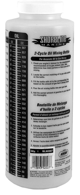

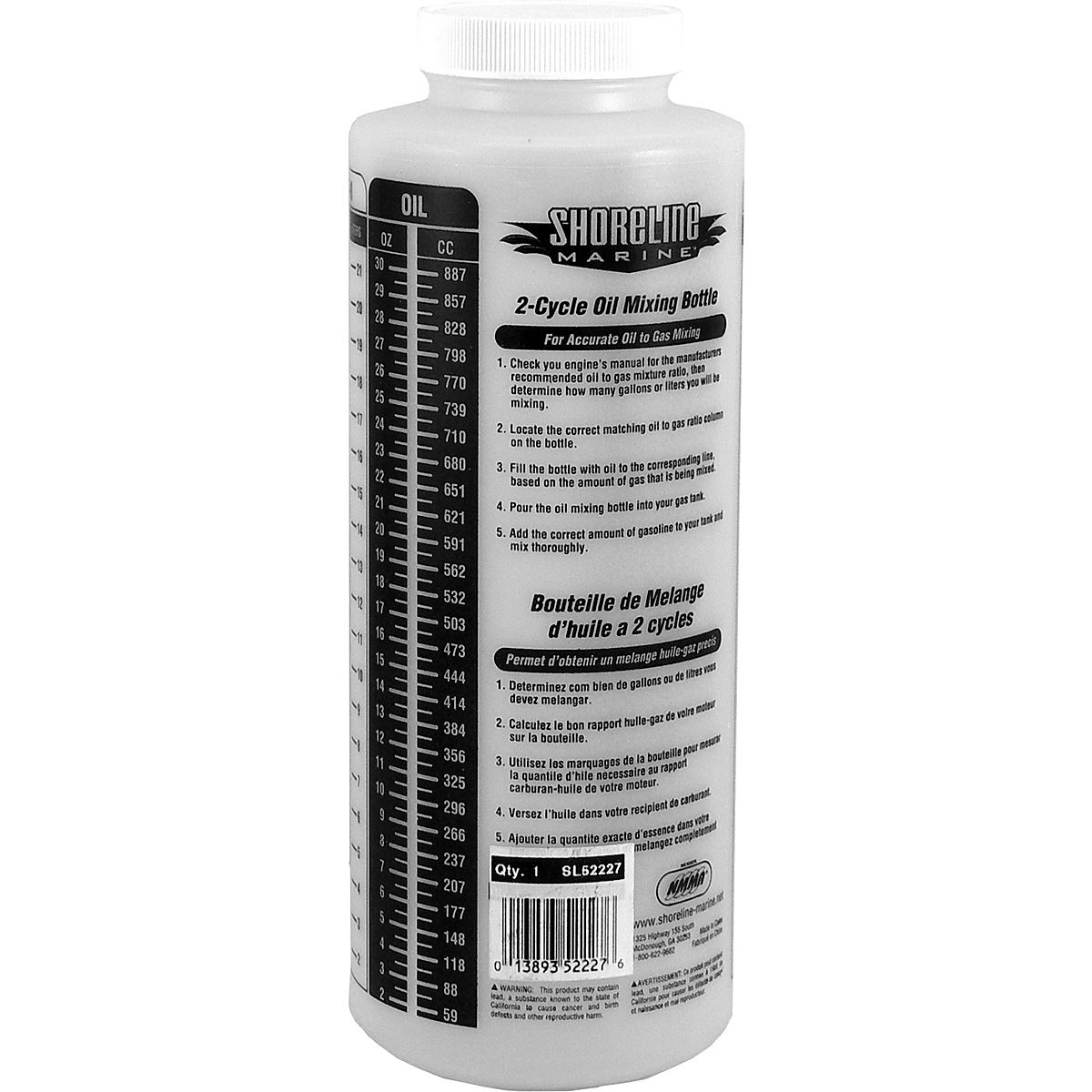

Get one (or a few) of those, the key is having the top that you can seal so you just seal it up and it won't make a mess from that little bit of oil that never comes completely out, I have a handful of them so I can put one in the shop and one in the trailer and so on wherever I might need on. 1 pint to 5 gallons is 40:1, the mix I choose mostly out of convenience.

Mixing bottle: I got mine at Canadian tire (noticed you're in Canada)
