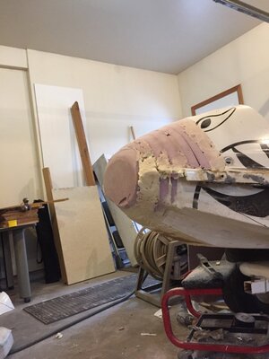

I recently started building my 750 cut the nose foamed and now I'm just about ready to start glassing(or carbon). I'm just not sure what I should do so I'm turning to you guys for some help and info!

Here's a picture of what I'm working with ( don't be too harsh the picture is an early one)

I hope you have done a lot more work since whe you ae in this picture. I recognize that you have said this is an early picture. I thinm your Nose in this picture is going to make a much better batterkng ram than jet ski.

Thank you very much! This is all great and helpful info the project is in the early stages and that was the only picture I had handy so yes there is a lot more shaping to do! Thank you so much for the help Vumad check out the build thread on my ski if you would like to stay posted as to what I am doing! Thanks again!
