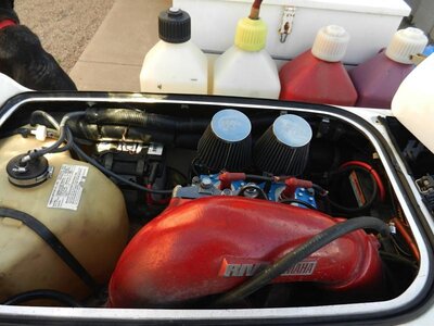

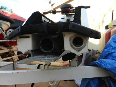

i have a 96 sj looking to get the most low end possible. what pitch should i go w? 12/17 13/16 12/15 skat solas? swirl?
rebuilt 61x 701cc w/ 3 tanks of gas through it.
riva red pipe
protec head
protec intake grate
stock pump
going to d cut my protec ride plate
going to buy a trim
