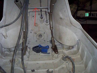

I have an 89 hull I am selling and it has the direct cable. It looks less complicated but everyone says it sucks!
Fnny thing is the sub plate and steering system were all the same. The sub plate even has a place for the squeirl cage to bolt up to.
i have an 86 750 x2 w/ a cage steering and a 89 or 90 hull with direct. if im not mistaken, the direct cable is fine if you sleeve the long rod under the hood to keep it from bending. my 89 (90?) hull has a beefed up cable so im hoping its okay for a future build.
is there any difference in ratio or ease of steering between the 2?
