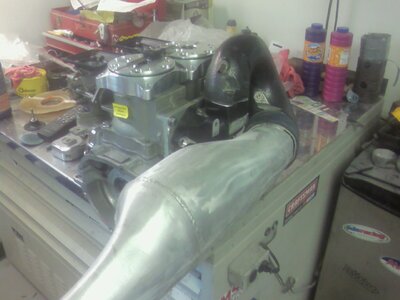

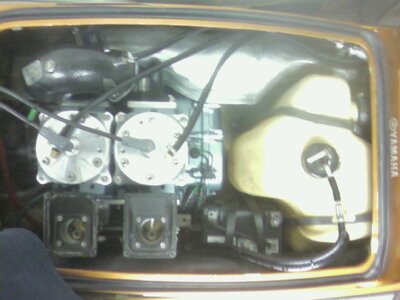

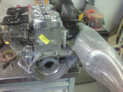

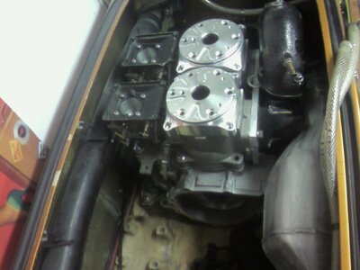

where did all the 66e builds go? anyone have a link or two to a build using ATS_aaron's pipe? The new pipe is nice for sure. I'm wondering what hulls it has been successfully fit into as the chamber is huge compared to the original wdk pipe

There are tons of guys running B-pipes on PV dasa why would that be any different than this?
An adapter from a 66e motor to a 61x b pipe manifold won't work. The spacing is way too far off and you don't have much room to make up the difference and still fit the pipe in the hull. I've seen an adapter to a kawi manifold for a 66e. maybe the spacing is better.
Well as some of you know I'm attempting it again. http://www.pwctoday.com/f100/full-yamaha-800-x2-build-illinois-360326.html
I'm not sold that the new pipe will fit in anything. Thats why I'm looking for as many pictures of the new WDK pipe in different hulls as possible.
The motor in my X2 is set back as far as possible right now and the original WDK pipe barely fits. The new one that I bought from ATS_aaron has a huge chamber, but is simply a work of art. Fitment is a foreseen issue now. But I won't be home until Friday evening to mock everything up though with the new pipe.
If the new pipe doesn't fit think a few inches can be taken off the chamber to make it fit? or just run the old WDK pipe and save the new one for a BOB next winter
Ya I have thought about it. but I'm not the one doing the glass work. my Buddy is. I may need to ask him
as of now probably won't cut the new pipe at all.
