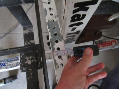

I want to make my two place standup trailer into a 3 place
where can I get 1-3/4 or 2 inch tubing with holes similar to the picture?
....Someone say sign posts?
IN
they have sign post stock for 30 bucks at grainger. I need to see a design where they raised the skis over the fenders. I did order 4 bunker brackets from overtons

I used the sign posts to raise my bunks over the fenders. The posts work great being that they are galvanized, strong and the holes give you an endless amount of tie down points. I used galvanized joist hangers from Home Depot to hold the 2x4 bunks.
