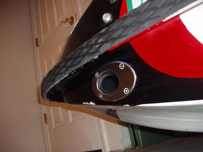

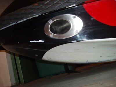

I use our water jet to cut the outside flange ellipse and on the inside of the ski I also have a flange the same shape that is tapped for the 10-32 machine screws. The pipe is a piece of sanitary tube 2" that was cut ellipse to fit the out side flange welded then sent over to our polishing department. Any custom shop could make you something like this.

How about Mark44's Custom shop? How much to make a couple more? Thats great! :Banane09:
