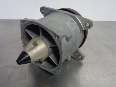

All 750 800 pumps are the same except the 750zxi. It's either an ss or ssxi that has 2 big holes that need to be plugged or it cavitation like he'll. I sell those for 220 shipped in cherry condition
My understanding is the 750 and 800 pumps are the same except, like mentioned, the ZXI which has a seadoo style mounting flange so it's easy to identify.
The SXR 800 pump is just a 750 pump with big hub impeller.
Don't trust mint or cherry descriptions before you buy, get them to measure the pump wear ring and show photos of the veins. I replaced the wear ring in the "mint" 750 pump I got. It was far out of spec. Wear rings are quite easy to install.
