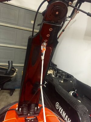

I just got an adjustable Xmetal pole and I am looking for a place to mount my limiting rope and I really do not want to drill into the handle pole. Any suggestions on where to mount the limiting rope and with what and how?

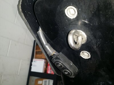

I just drilled a small hole behind the steering. My pole isn't new but it's clean AF but whatever it was the best way to go it's not going anywhere and my hood pad can stay where it is

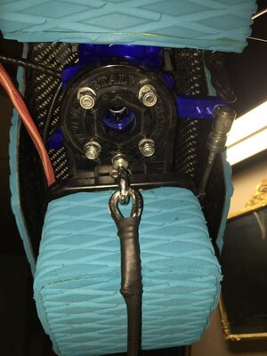

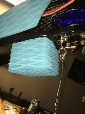

I drilled an additional hole in the channel where the pole adjusts and just used a umi limiting rope attachment on the bottom. Still adjusts like it was designed to there is just one more bolt to loosen
