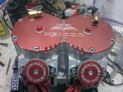

I'd like to know who all is running an XS1000? anyone care to list their setup from carb to pump?
Getting ready to drop one in a 60lb Fx1 hull with 49 full specs, LTD B pipe, new style XMW waterbox, 5 gallon superjet tank and 144 mag pump :bigeyes:
I know the 148 pump is ideal, but has anyone run one with a 144? prop and nozzle recommendations?

49's, MSD E, avgas, stock lightened FW, b pipe... I was running a 14/19 with a 148 Mag S/N.... So tell me how the 13/19 is going to work in a 144?
Better find a 15/20 or 16/21 running the 144 pump

Thats going to be one nasty FX.. but you are the man to have one... if you set that pump back 2 inches will that help any??
That is going to one nasty FX.. but you are the man to do it... If you set that pump back 2 inches would that help on a smallish pump??
