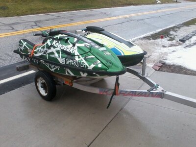

Been searching google and the x for about two hours and can't find any pics of an sxr set up with that pole. Do any of you guys run one and if you do can you post up some pics and how you like it. Also it says there steering system is adjustable -2.5 to -3.5 so with there pole and steering you can go -6.5?

I used to run an xscream pole with rrp steering system on my 11' sxr for one season before switching to rrp pole with cold fusion steering sytem. It was a nice setup and very short for a sxr. I pulled off a couple awkward barrel rolls off yacht wakes. The reason I went to rrp pole because it was easier to use for a sxr. I snapped the steering cable in the area where the xscream pole bolted to the bracket. The pole is so thin and it creates an extremely tight angle when pole was pulled down to the hood. The cable couldn't handle the bending angle and snapped.
I have some pictures but I'll have to find them after I get off work.
