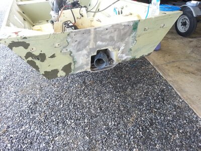

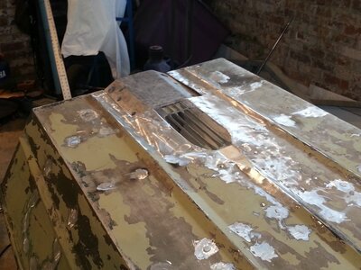

Here are some pics from the early stages of my build last year. Its a pos 14ft.

Also my donor ski was a vxr which is pretty close to square nose parts. The other boat was a wr3 which shares very little. In my opinion the vxr is the best boat building hull. It has short drive shaft and mid shaft compared to most couches. A square nose would make a good build too.
