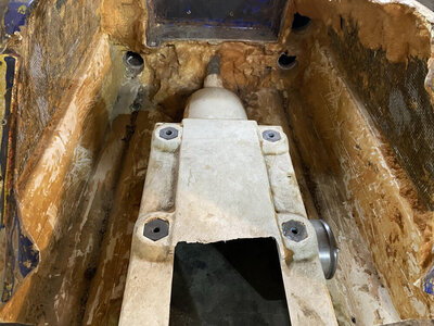

I am rebuilding my try on my Superjet and need a thru-hull tube. Does anyone have one? Thanks
SuperSquid Location 40207 Aug 16, 2021 #1 I am rebuilding my try on my Superjet and need a thru-hull tube. Does anyone have one? Thanks
Kohldanielzimmer Sierra Nevada Runoff Rider Site Supporter Location Ahwahnee, CA Aug 16, 2021 #3 I bought mine from mcmaster carr (stainless).
SuperSquid Location 40207 Aug 17, 2021 #4 What size did you buy? What did you use for a flange to exit the back? Thanks
Big Kahuna Administrator Location Tuscaloosa, AL Aug 17, 2021 #5 You just need a Stainless tube with 3/8" OD.
Kohldanielzimmer Sierra Nevada Runoff Rider Site Supporter Location Ahwahnee, CA Aug 17, 2021 #6 Correct diameter hole and Plexus to seal, no flange used.
