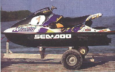

Here are some pics of Dustin Motzouris mod hull that he raced in the late 90's. I believe its a wammer hull, but I'm not positive. Look at the transom and you'll see what Im talking about.

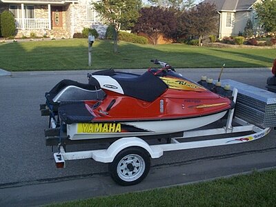

ScottieMac actually has a Wamiltons Mod Hull. I'm sure everyones seen pictures of his ski, but here's a pic anyways.

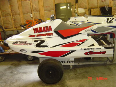

Recognize the second blaster Tim? Yep, thats Reeds B1. I found that picture a while back and I knew I had seen Reed's ski somewhere before. The picture is actually from when some guy in Kansas owned Reed's ski.
