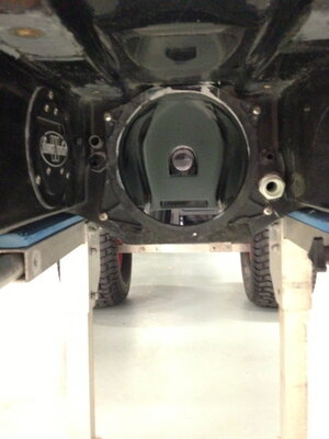

well here is what a pump duct for a 155 looks in one of my new FP! hulls, you will see it does hang a little lower on the bottom of the ski and we had to modify the duct a bit to make it suit , but it is not unachievable , testing in a week or two with just a stock 760 wav blaster motor with head and pipe , stock 6 vein pump
We had to reposition the inserts hence the grind makes which still need to be sanded and buffed but not to bad if i say so photo-51.jpgphoto-53.jpg

forgot to mention the top of the pump needs to be ground off so the ride plat fits , also not sure but we actually fitted the fire wall when doing the pump so ours is aligned perfect with the motor , not sure how it will work with a stock superset but i can say i can now fit a 155 in my ski,s , weather i offer this option no idea yet LOL

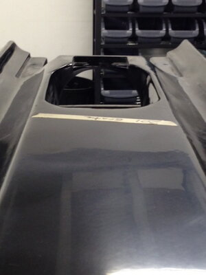

Here is what i ended up doing to get mine to fit. Cut out the shole pump mounting area and glassed in a new mounting plate. Still have to finish and paint but it worked out pretty good.
Did you use the stock 144mm plastic pump shoe or the 155mm Blaster-II pump shoe?
