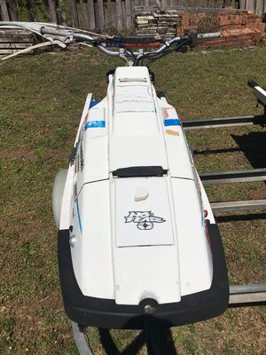

Right now im tearing down my 550 to repaint it and fix a couple of cracks that developed in the hull. I have photos and will upload soon. I had some questions about redirecting the intake vent on the hood to face backwards. has anyone had any experience with doing so? i could only one pic of someone doing it and i was wondering how it would affect the engine having less air pushed into the engine compartment. something like this.

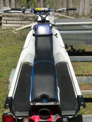

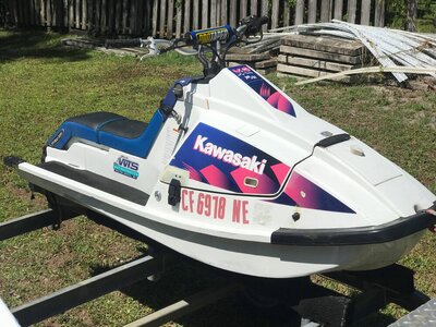

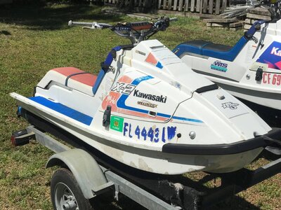

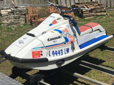

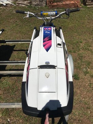

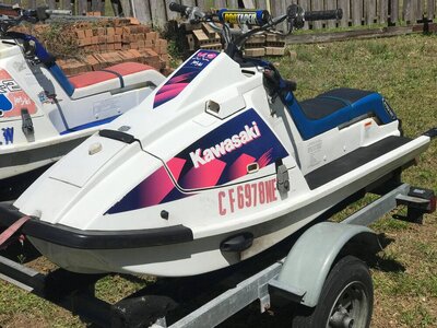

here are some photos of my ski before the teardown. it was in great condition compared to some but I got it for $600 and i wanted to paint it blue and work on the hood like the above^^

Is that how you're going to fix those cracks? Id recommend drilling out the cracks, and then laying some fiberglass over them.

I wouldnt pull it if it spins easy. It can be hard to get out. The Kawis pump shoe is glued in the hull. It is the bottom of the ski, no one sees down there and its usually always scratched up.
Check out my thread http://www.x-h2o.com/index.php?threads/first-ski-build.139833/
I'm almost done my 550 I took step by step pictures they might help. I didn't take my pump out to much work we taped it off and painted around it. I wouldn't recommend going crazy as far as the hood it's going to add up quick and you already paid on the high end for that ski. Lastly I'd take out those metal pieces you put in and do like roseand said cut all the crap out and fibreglass then find a beef it kit on here usually some for sale.
The rivets I put in with the stainless steel bars seems to make it extremely stiff, but I have the materials on hand to fiberglass it so I think I will. I might just fiberglass the plates in there. At least the long one on the sides and remove the one in the hood-line. And just masking off the pump is what I'm going to do because it doesn't need to be replaced or anything it's still in great condition. Thanks guys! Pic Updates tomorrow, most of the engine is apart and getting it ready to bead blast the exhaust and header for paint!
