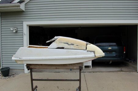

i was having a hard time getting the glass to lay right in the back of the hull so i took some ziplock bags and filled them half full of water. then i layed them in the back of the hull and it forced the glass in to all the corners. it worked out great

i have the 3/1 hardener and and im using that 1708 stuff from us composites. then i lay two layers of really thin glass that i had laying around over top of it. the thin stuff sands A LOT better and give a better finish. i started working on the nose toady im poring the foam in a few minutes.

i cardboard down so the foam wouldnt fall through the hole. then i put blocks of foam on top of that and taped it so the expanding foam wouldnt push it around. it
work out very well.
